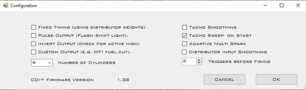

1) ‘Fixed Timing’ means that the CDI unit does not adjust the timing.  You need to clear this box in the configuration (no tick) to enable the CDI+ to control timing.

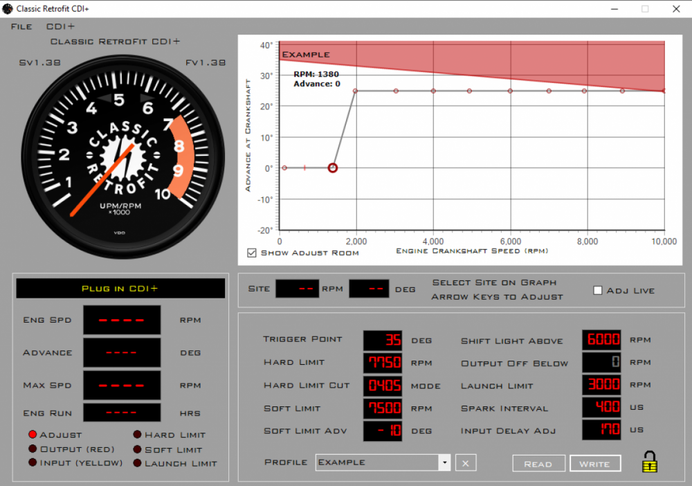

2) Take the maximum advance required for the engine and subtract the static advance (typically 5 BTDC).   30 - 5  = 25.
3) Draw a ’simplified' curve (below) with max 25 and set the ’Trigger Point’ value high enough so that the graph is below the red area.  (the 0 idle area is just so you can start the car easier)
162485696_ClassicRetrofitsimpleignitioncurve1.thumb.png.2fd3e9189e15de24685557743a270900.png
4) Start the engine and bring it to 2000 RPM+ and adjust the distributor so the timing light reads 30 deg.  (in my graph anything above 2000 gives 25 plus the 5 static = 30).
You now have the timing dialled in so you can do anything you like with the curve.
