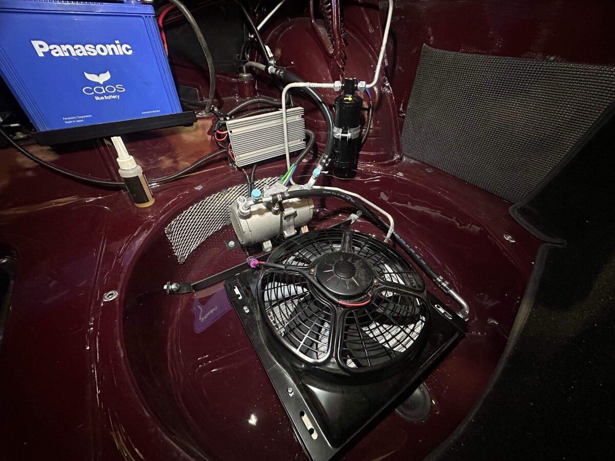

I also live in Japan and am suffering from this terrible summer heat. I installed an electric air cooler system (non Classic-Retrofit) in my vintage Alfa Romeo, but it hasn't been as effective as I had hoped, so I am looking for ways to improve it.
After reading your post, I was truly amazed at the high level of cooling performance you’ve achieved with the electric cooling system. If there are any tricks to it, I would greatly appreciate your advice.
For example, “dual-condensers are mandatory for this result” or “the Classic-Retrofit’s Compressor offers vastly superior performance compared to those from other manufacturers, so you have to replace the compressor at first”, etc.
