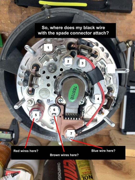

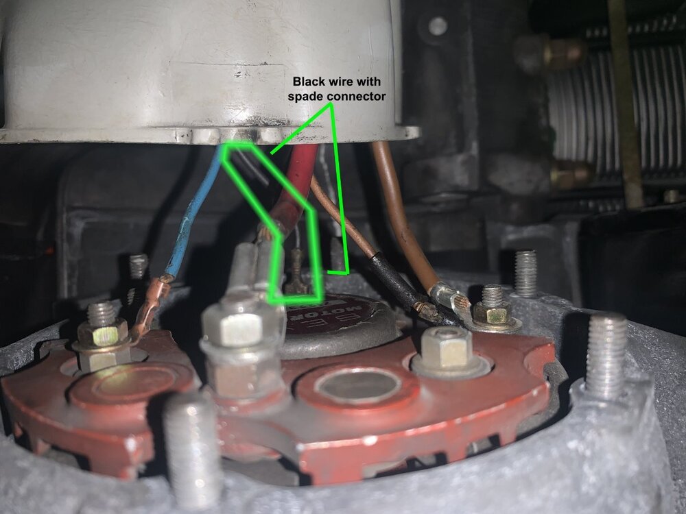

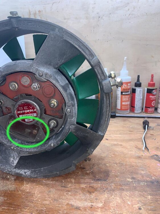

Sir Ken Posted August 23, 2024 Posted August 23, 2024 Howdy: 1971 Porsche 911E Coupe is what I am working on in this example. I have removed the current alternator but did take a few photos beforehand. This photo shows the wires as they were connected prior to removal of my original alternator. The black wire with a crimp spade connector (green outlined in photo) is my first question. Where does this black wire with spade connector attach on the new 175 Amp alternator? Also added pic of my old alternator and where the black wire with spade connector previously attached (circled in green). Quote
Sir Ken Posted August 24, 2024 Author Posted August 24, 2024 I'm going to assume this is the black (DF) wire that is cut off prior to removing the voltage regulator. Quote
Jonny Retrofit Posted September 6, 2024 Posted September 6, 2024 @Sir Ken. More info can be found in the Porsche service bulletin for updating a external regulator alternator to an internal. This was a procedure carried out at Porsche dealers when someone bought an early car into the workshop. Link below: Quote
