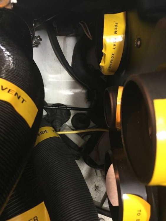

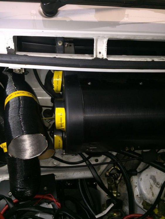

On my '87 930 I finally completed the a/c install, pulled vacuum and charged w/R134a today. I do not have a temp meter so I have no idea of the outlet vent temp. I will report its vent temp once I get a temp meter. It does feel cool/cold so I felt confident to go for a test drive immediately with my wife while outside temps were in the 90's. We were comfortable during 45 min drive beginning around 4pm central time. The only issue I have is there's low air flow output from the central and passenger side vents. I think this is due to two reasons. 1) One outlet blower port feeds into both central and pass side vents which is a stock setup. 2) The flex hose from the blower to Y-connector which feeds the central and pass side vents is long and convoluted to go around other flex hose. Perhaps these two are the reasons for reduced air flow at the vents. Neither 40mm ports at the blower are used and are capped off.
