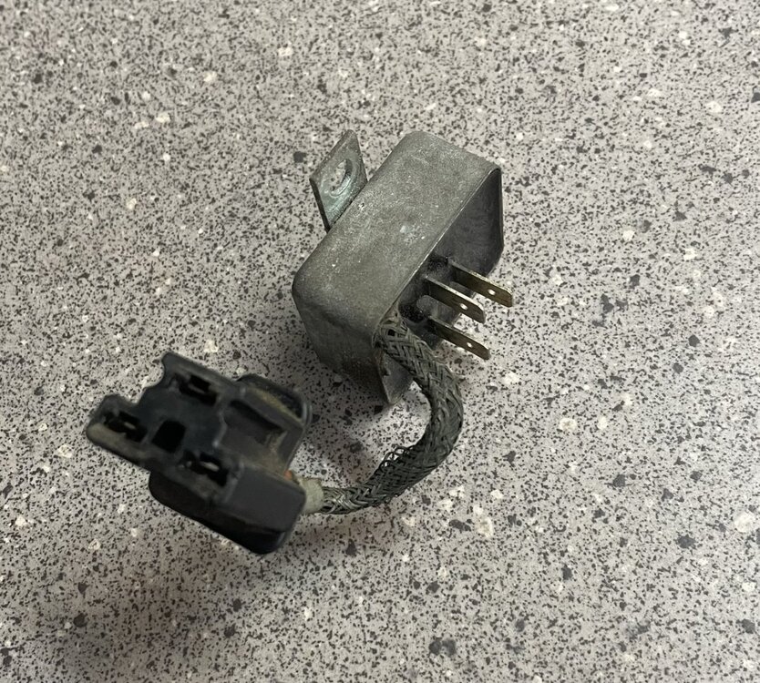

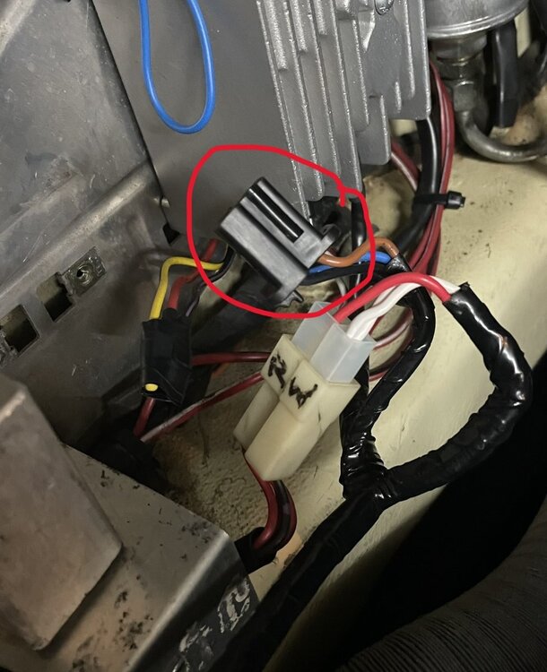

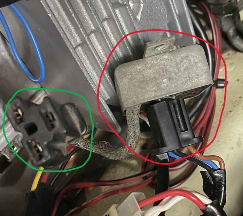

Jason Wright Posted March 19, 2024 Posted March 19, 2024 Hi Everyone. I have fitted the 175a Alternator upgrade to my 1977 911S and I have a question regarding the Porsche Bulletin that was included in the Instructions. Can anyone clarify that I have interpretated this sentence correctly please? "Fasten multiple-pin plug of removed regulator on wire harness" Here's the multiple pin plug that is from the regulator that I removed. Here's my Engine wiring loom that was originally connected to the Regulator. Plug circled in red. Have I read it correctly by connecting the multiple pin plug (from the removed regulator) to the engine loom, circled in red, as below? The plug circled in green will just be secured to the loom and not plugged in anywhere as there is nowhere for it to go now. I would really appreciate some feedback before I turn the key. 🙂 Many thanks. Jason. Quote
Jonny Retrofit Posted March 19, 2024 Posted March 19, 2024 You take the regulator out of the car completely. Anything left just secure to stop it flapping about. Quote
Jason Wright Posted March 19, 2024 Author Posted March 19, 2024 Hi Jonny. Thanks for coming back to me so quickly. 👍 OK, so the grey box in my last photo is actually the regulator? Cheers. Jason. Quote
Jonny Retrofit Posted March 27, 2024 Posted March 27, 2024 On 3/19/2024 at 11:01 AM, Jason Wright said: OK, so the grey box in my last photo is actually the regulator? Yes it is. No longer needed. Quote
