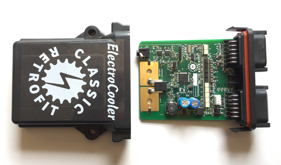

classicretrofit Posted January 21, 2024 Author Posted January 21, 2024 ECU ElectroCooler’s ECU provides the necessary control to regulate the compressor speed in accordance to the power available from the charging system. Without the ECU, the compressor could run beyond the means of the alternator which would result in a flat battery. Either that, or the compressor would be run too slow and compromise the A/C performance. The ECU contains an algorithm that adjusts the compressor speed (and thus current) based on alternator output, battery voltage, driving conditions and a number of other factors. The ECU comes preset with conservative working parameters. It is possible to adjust the values using a laptop as described in our setup manual. It is strongly recommended NOT to adjust these values without reading the manual or consulting us first. The ECU is housed in an automotive enclosure and has two keyed 12 way Deutsch connectors, accepting female 0462 crimp contacts. All wiring to ECU to be 14/0.30mm, 1mm2., 8.75amp. See the ECU wiring details here. Air Conditioning Half Kit The half kit is essentially all the parts of the full kit without our replacement blower. It uses the factory evaporator/blower located in the smuggler’s box on a LHD car and behind the passenger footboard in a RHD car. The installation is the same except for items relating to the blower.
