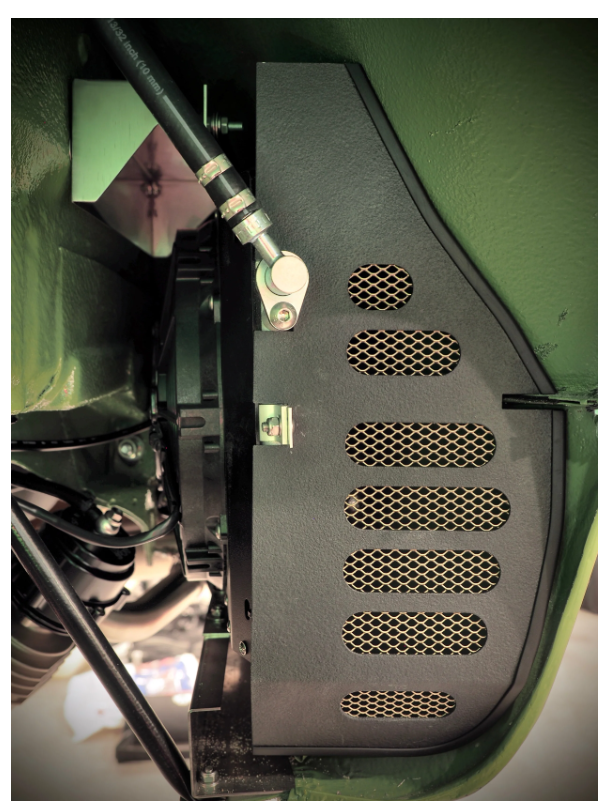

On early LWB cars (1969 – 1973) the twin battery boxes prevent the installation of the condenser in the front fender.   It is possible to mount the condenser in the rear fender.  We do not supply a bracket for this position but the condenser can be mounted on rubber mounts (sometimes called ‘cotton reels’) or by fabricating your own bracket.   Please note that the fan itself has a stone guard but if the condenser radiator faces the wheel then an additional mesh guard will be need.
Rear condenser placement on the right side
Rear condenser placement under tail light (needs stone guard)

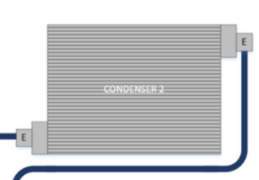

It is important to maintain 'Horizontal orientation of the condenser, Turning it will compromise performance.
