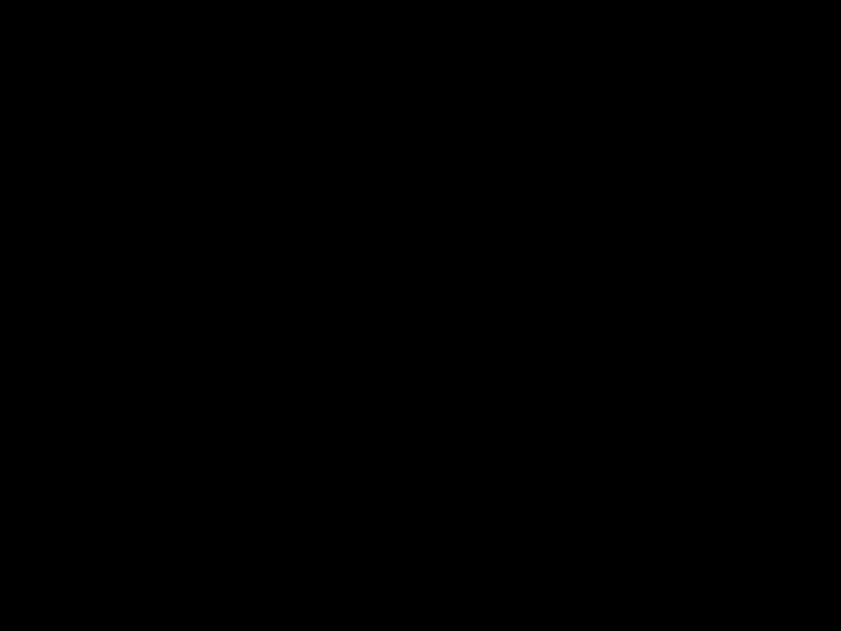

OK after seeing you today Jonny I tried disconnecting the orange wire but that made no difference - it would then not switch on at any blower speed Coming home it would only work in blower 1 position which wasn’t enough to keep it cool. So then I ran some tests and produced some diagnostics On the diag output I seem to be getting the right/expected violates from the BLO readout but almost all of the time the diagnostics also says blower off. So with the engine running and blower on 1 I’m getting 7.8 v or thereabouts, on 2 it’s 3.8v or thereabouts, and in 3 it’s 0. Something volts. However each time the second to third item on the diagnostics says ‘blower off’ but I can hear it and feel it running. I tried disconnecting the orange wire again while running diagnostics and sure enough that changes the BLO voltage to 0. Something but the readout still says blower off.. On the attached screenshot I had the engine running and switched it to highest blower speed. It kept saying blower off Throughout all the the blowe voltages seems to behave as it should do - the connections on my sliders may not be great but I don’t think that’s the problem as the correct level of voltages is getting through. However that Parameter BlowerOff barely ever changes. I’d welcome some suggestions
